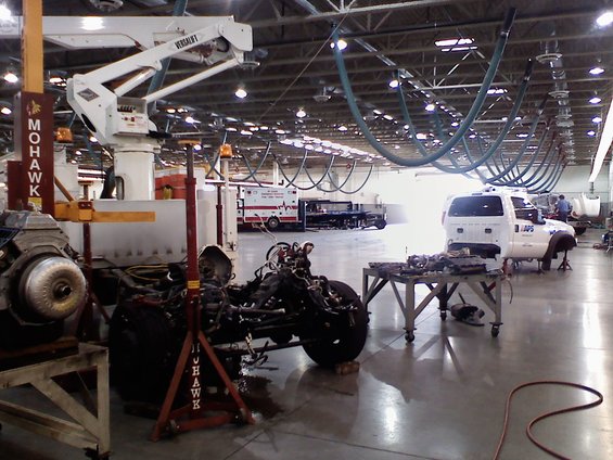

Brad Clayton Posted October 30, 2008 Share Posted October 30, 2008 That's a strange lookin' flywheel on that motor. /forums/images/%%GRAEMLIN_URL%%/smile.gif Quote Link to comment Share on other sites More sharing options...

Keith Browning Posted October 30, 2008 Share Posted October 30, 2008 By the way Dustin, did I mention that every time I see a picture of your shop I get really jealous! I keep my floor clean in my shoe box of a shop and it still looks like dirt. /forums/images/%%GRAEMLIN_URL%%/frown.gif Those polished concrete floors in that wide open space look like a techs palace. Quote Link to comment Share on other sites More sharing options...
DieselD Posted October 30, 2008 Author Share Posted October 30, 2008 That's a strange lookin' flywheel on that motor. /forums/images/%%GRAEMLIN_URL%%/smile.gif yeah well getting torque converter bolts off when the engine will not even turn over is pretty much impossible, haha. lets just say it was not fun to get out without jacking up the shaft. no comments on why the cab is sitting in the other bay? maybe I shouldnt say /forums/images/%%GRAEMLIN_URL%%/cover.gif yes I have thought about the turbine wheel actually. there was no mention of it in the story but we all know how well those history storys come up in oasis. I did want to stick my bore scope up there and look for it but got side tracked. I think I will take it back down and check it out. worth a shot at this point just to be sure. I actually have a picture of one Ive come across in the past. Ill dig it up. Quote Link to comment Share on other sites More sharing options...
Bruce Amacker Posted October 30, 2008 Share Posted October 30, 2008 Those polished concrete floors in that wide open space look like a techs palace. I wonder if he wears shades while in the shop? The glare is killing me.... /forums/images/%%GRAEMLIN_URL%%/cool.gif Quote Link to comment Share on other sites More sharing options...

LARRY BRUDZYNSKI Posted October 30, 2008 Share Posted October 30, 2008 Did you guy's notice the ambulance in the background? Nothing said about that one. /forums/images/%%GRAEMLIN_URL%%/cover.gif Quote Link to comment Share on other sites More sharing options...
eastendpowerstroke Posted October 31, 2008 Share Posted October 31, 2008 yeah I saw that but I was thinking how nice that much space would be!! my shop isn't the smallest place I've worked but I can hardly turn around with out bumping into myself. Quote Link to comment Share on other sites More sharing options...
