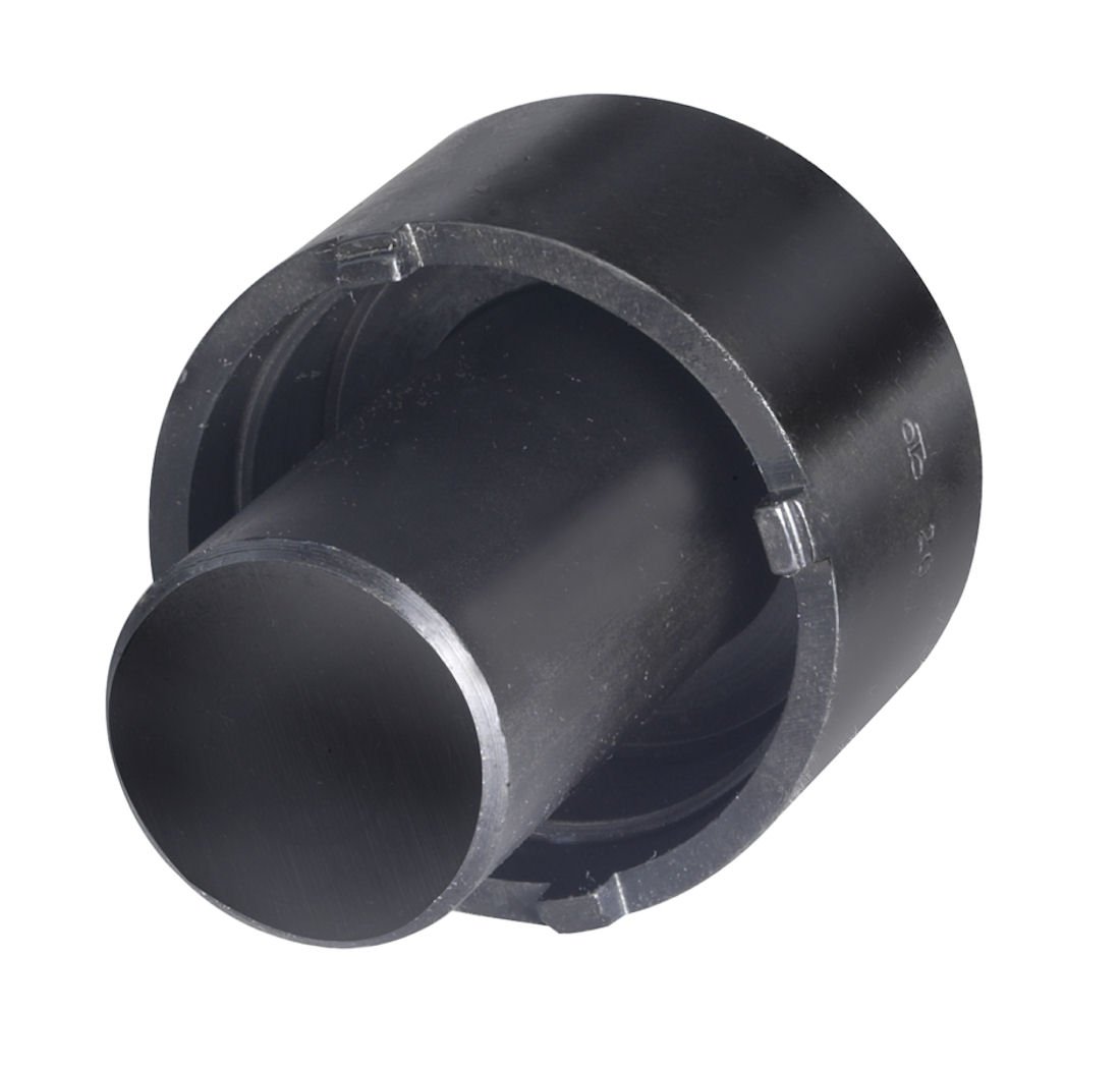

PowerSToKed Posted March 4, 2014 Share Posted March 4, 2014 I can't find this anywhere, the book says "use suitable socket", I know it is 8 sided but do not know the size. A tool # or size/ID would really help if anyone knows it. Quote Link to comment Share on other sites More sharing options...

Keith Browning Posted March 4, 2014 Share Posted March 4, 2014 No, he's talking about the 8 point stamped steel wheel bearing nut, typically 3/4" drive. I have one at work... cant tell you the size right now. I could "recollect" but I prefer to be accurate. Will post the size as soon as I can put my hands on it in the morning unless someone beats me to it. Quote Link to comment Share on other sites More sharing options...
Matt Saunoras Posted March 5, 2014 Share Posted March 5, 2014 I don't know about 2008 in particular but the socket I use on 450s and 550s for the rear wheel hub is 3 1/4" and yes it is quite large and 3/4" drive. The 2011 550 I did today was the same size as I've seen in the past. edit - Blue point ANS1909A is what I have. Yes it is 8 sided, and no (until now) I did not even realize it was 8 sided. Quote Link to comment Share on other sites More sharing options...
Keith Browning Posted March 5, 2014 Share Posted March 5, 2014 I will confirm what matt posted 3-1/4" 8 point Quote Link to comment Share on other sites More sharing options...
tonybullitt Posted March 5, 2014 Share Posted March 5, 2014 Mine is 3 1/4 matco an-1909 Quote Link to comment Share on other sites More sharing options...
PowerSToKed Posted March 5, 2014 Author Share Posted March 5, 2014 Thanks!!!!! Ordered one this Morning Quote Link to comment Share on other sites More sharing options...
ktmlew Posted March 5, 2014 Share Posted March 5, 2014 http://www.amazon.com/OTC-1909-8-Point-Octagon-Locknut/dp/B000LQB4EY Quote Link to comment Share on other sites More sharing options...
DieselD Posted March 14, 2014 Share Posted March 14, 2014 http://www.amazon.com/OTC-1909-8-Point-Octagon-Locknut/dp/B000LQB4EY OTC is what I own. cheap and works. Think I even picked mine up from amazon just make sure you have a 1/2 to 3/4 adapter. There is no need to run a 3/4 drive for this application. Torque is pretty light on these Quote Link to comment Share on other sites More sharing options...
