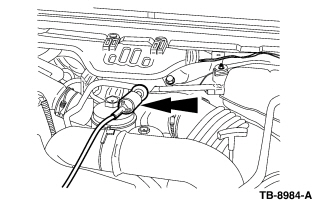

tonybullitt Posted January 16, 2015 Share Posted January 16, 2015 From tsb 9-8-3 Road Test For Leaking Head Gaskets - Setup And Observations: Install the vehicle measurement module (VMM) pressure vacuum transducer (PVT), or Rotunda Pressure Adapter Kit 014-00761, or equivalent. (Figure 4)Figure 4 - Article 09-8-3 CAUTION: CAREFULLY RELEASE THE COOLING SYSTEM PRESSURE WHILE REMOVING DEGAS CAP. Carefully release the cooling system pressure, leaving the tester in place. Seal pressure bleed. Drive the vehicle at wide open throttle (WOT) / high load / to achieve maximum boost. Observe whether the cooling system pressure exceeds the holding pressure noted in Step 2e. Check for coolant venting through the degas bottle cap by listening for a hissing noise. If the cooling system pressure is less than the holding pressure noted in Step 2, go to Step 10. If the cooling system pressure exceeds the holding pressure noted in Step 2, and/or the degas bottle cap continuously vents with loaded engine, go to Step 8. 1 Quote Link to comment Share on other sites More sharing options...
